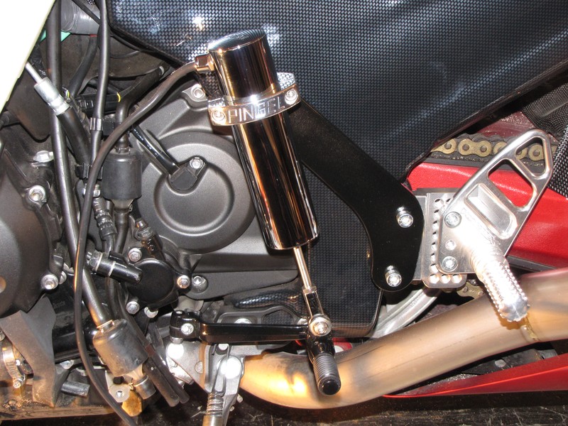

IDK Scott.Be assured SOMEONE read your post here....I'm just wonderin where all the "expert electrical guys" are at?You know...the three amigos guy(s) or whatever Maybe ya need a 'tone wheel' tune up first?
BY GOD!!!!Thar she be!!!!!Yer TONE WHEEL...right there....in that pic.HUB? .....I found it...your infamous TONE WHEEL!!!Funny thing though...it doesn't LOOK like the "tone wheel" on the front and rear hubs of the new 14 You think maybe she's got...TWO tone wheels on there? (two tone...get it?...okay,yer supposed to laugh now) ...Nevermind.

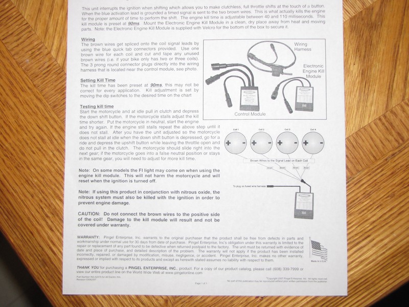

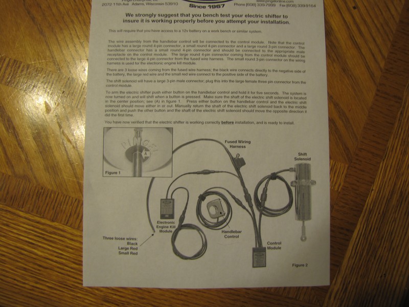

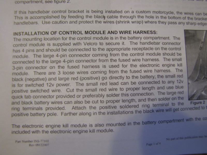

heres the instructions i have:
* Last updated by: scottjkyl on 11/21/2011 @ 4:28 AM *

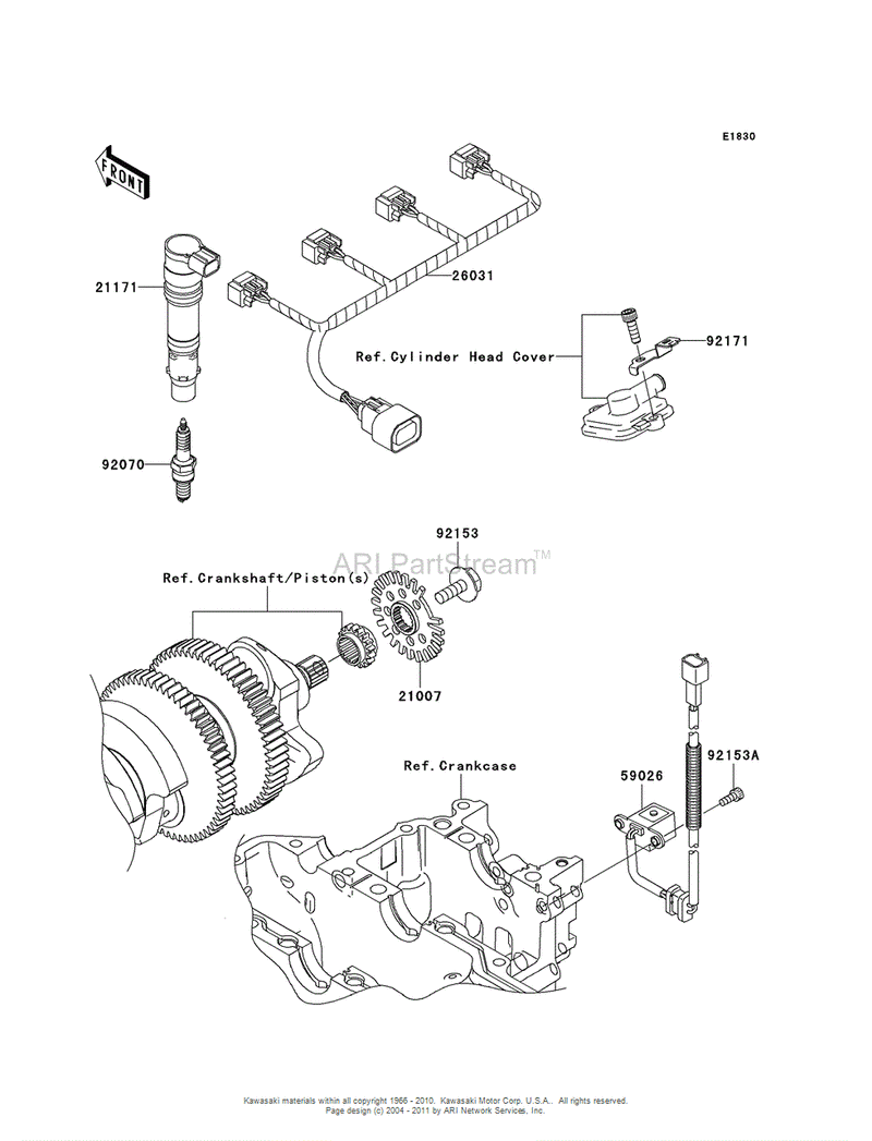

this is out of the zx14 fiche. To me it looks like the 4 positive wires and 1 grnd wire goes to the plug from the coil sticks I'm just wondering if i can get away with just splicing into that 1 grnd wire instead of all 4 at the coil plugs
or do i have it backwards and all the R wires are the positive?
* Last updated by: scottjkyl on 11/21/2011 @ 4:45 AM *

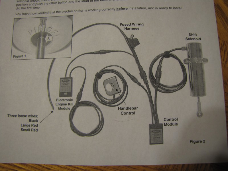

this is how the whole shift sys ties together

No. That would mean you either one wired into the 4 grounds or you wired into one cylinder. See the coils have 4-red wires? Consider those ground if all have the same color [think]. Plug the brown wires into each color coil wire.
The 2 reds and one black? Where is that wire diagram? I'm going to guess:
Black = Ground.
Red-Lg = (+) battery side with fuse in between.
Red-sm = Goes to the tone wheel wire to kill the spark to shift without load for a mill of a second. Remember, these are guess is until someone who has one shows up says [something] completely different or you shoot the diagram/directions.
Then again, you could take the small red, use that for your suggestion if that is what you meant. I would now hook it up to the small reds on the coils = pick one.
* Last updated by: Hub on 11/21/2011 @ 7:21 AM *

Hub accorrding to diagram both big red hook to pos side,and black to neg of battery,small red is for switched 12v power, and can be connected to any12v positive switched wire. the only wires that go to coil stick harness are the 4 brown ones

I would then run a toggle switch with a light in it. This way, the small red wire is not shorted to ground, but more the resistor (the bulb showing she is turned on). Unless they fake the red wire as being a ground, meaning. To find out?:
1. Black is to ground.
2. Red-L is fused.
3. Red-s is touched to ground. If you see an arc you have cat reflexes so as not to blow the fuse? That says red is direct from battery to ground. Or? It says, I am not hot to shift I am now grounded via remote (-)red-sm is more or less a toggle on/off option? Because, it would seem like you run it to the hot running taillight, that is key off/key on we have shifter hot without you being able to turn it off... sans key off. Therefore, is that small red for a toggle and the loophole from shorting that red is add the light inside the coffee type toggle switch.

Nope. No single brown to one wire that hits all those are the grounds. Brown has to run hot. Path says;
1. Brown = Chose any ~ goes to W/Y #4 cylinder
2. Brown = 3 left choose ~ goes to W/G #3 cylinder
3. Brown = 2 left, it's 50/50 from here ~ goes to #2 W/BL
4. Brown = 1 left ~ goes to W/R #1 cylinder
Again: Brown does not know when you shift on what cylinder. We are down to milliseconds of kill. That says; I have to know who is next to fire so I can kill... No wait! I am going to sit here, wait for the brown wire that went to one wire, you installed it for argument sake on #1. You want to shift at 10K and at that mark, it was on #2. So lets wait for 2 more fires so you can shift? No can do. Make sense? What time is it? shit!SHIFT! It's late!

Yes, we are going to drag this out till we are all on the same page, we agree what wire goes where and what the instructions say. Find the circled 25. That is our coil bank. That is our wire harness. 8 wires, 4 with one color only. The rest say a main color and another line of color in the wire wrap. W says White with a tracer color. You see W/Br? That says, White wire with a brown tracer. The tracer can have a band around it, 2 bands around it, or 2 lines of tracer on each side of the wire's covering.
"The brown wires get spliced into the coil's signal leads..." This does not say, "the brown wires get spliced into the coil's ground leads..." Are we on the same page we read that the same??? You need to show me where is says to run the browns to a ground or a signal? Signals says ECU wires from the spark box to the coils. R for red wire means; R stands alone as one color. They are all the same and they tie into the kill button.
Bring the data that says different or have we established where the 4 brown wires go? If you think about it, why would you send a wire to ground? If it is grounded, what do you unload? What do you shut off? From ground, I think it is impossible for the brown wire to recognize spark, being it is sent to ground. Spark has to jump to ground to create the spark in the first place. Brown is sent directly to ground. Therefore, the key wording says, "signal lead."
