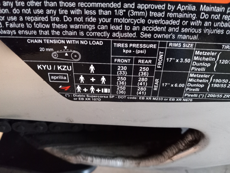

Hubstinator what is your take on this? For '21 and on RSV4s, Aprilia reduced to 20mm chain slack down from 30mm recommended on '20 and prior RSV4 models, see swingarm sticker below, also in the Owners Manual, not sure about the Service Manual as I haven't bought one yet.
A brand new '22 RSV4 just grenaded the countershaft bearing and destroyed the transmission with bearing debris and Aprilia is denying the $5000 warranty claim saying the chain was adjusted too tight. Those of us with '21 and '22s are concerned as we have been using the 20mm spec and it feels too tight.
Your text to link here...

Hum, late model 14r is 25-30mm. I run like a 2" slack. Real loose in other words. Tight I found it's mis-shifts if too tight. I'd run it loose and key tooth to chain link when changing tires. Swingarm shortens I think, when it goes under the wheel well. That should bend the sprocket shaft to load the bearings.
Run loose, it wont jump a tooth and probably shift better.

always run em a little loose to protect the counter shaft bearings and transmission.
Uncrated, the 14 have them tight for shipping. I'd say that tight would not help the longevity of the bearing of the engine or rear wheel bearings. Plus the churning and shearing away of the pins as it goes around the counter shaft and leaves a wider arch around the pin? That tight adds friction. That's where the stretch comes in. The counting of the 20 pins and measuring from there.
But to set it to book of ether gen's mm/inch, that is plenty of slack off of the arch, the load off both bearing ends, the less friction of the chain rolling, yes book is loose for that.
When I start noticing the slack on throttle pickup exiting a corner is when I readjust the chain slack.
It can't be from the chain wearing out. I've been swapping tires and the slack still winds up at the same position. I'm having a back to back wear test with Vic, and whatever lube he uses, and me with grease. If you want my opinion of that chain and engine case, that to me looks too dry. It should be caked with road dust and debris.
How many times per mileage do you lube the chain? I'm every 300mi and I never wipe the frame/rim off till I change tires. Helped a rider at the track this year: he mentioned an old turner's quote saying something like, 'lets make some HP.' He then started to lube the chain. If you take that bike out for the sport of it, I'd be on that lube every time out.
And that chain does no look OEM? Looks heavy duty. Your chain look the same? Weight saving links?
Something is off, Kruz? Sure it's not the oil degrading? Shifts real smooth when fresh, then sort of signs off close to its regular interval change?
Because, if I set it book, I miss-shifts more. I tried it loose and it seemed to work for me. I think of boiling water, turn the heat off, it stops boiling. So less slack means quick off, on lift, that top rung is going slack, and if it needs that touch of mesh of the dog into the slot, I've got a lot of give at the top rung and seems to stop, if I throw the sloppy shift at it.

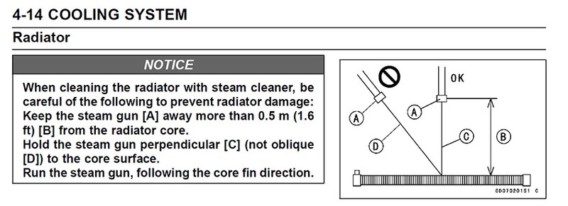

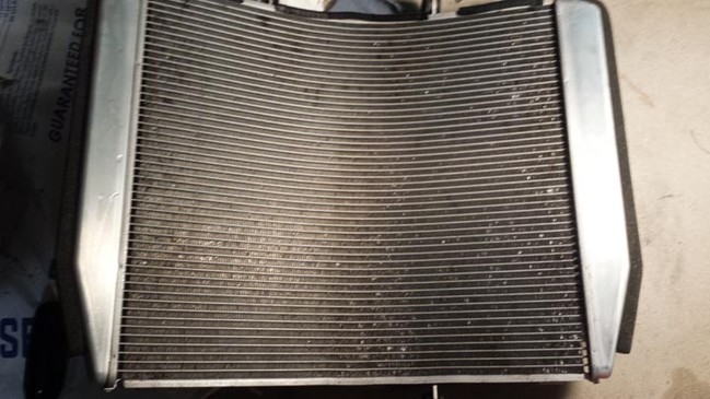

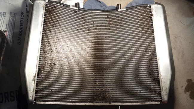

Very sweet Hub! On another note, I had some bad luck yesterday out on my favorite road on the Aprilia. Long story short, repair crew was doing some half assed road resurfacing and I got stuck waiting for the follow me truck to lead us through about 1/2 mile of torn up road. I found out too late they had peeled off the top surface and put some kind of soil stabilizer (guessing?) down with a lot of water on it before laying chip seal. It was sloppy wet and I had to go through it as I had a line of vehicles behind me. I figured no sweat, I'll hose the grey slimey muck off in the morning....wrong! That crap got everywhere, a big mess and a pressure nozzle wouldn't blast it off. It had to be removed with a sponge and soapy water, took me half a day to scrub most of it off the bike, every nook and cranny and I still need to drop the lower fairing as it's all up in there as well, man was I ever pissed off! It's all up in the radiators, especially the lower one and I'm concerned because RSV4s tend to run a little on the warm side already. Do you know a good way to get that stuff out of the fins without damaging anything? It is a mess! A super high pressure washer might do it but might also damage the cooling fins.
2021 Aprilia RSV4 2020 BMW S1000RR 2016 ZX-10R KRT 2016 959 Panigale Red 2015 CBR1000RR SP Repsol 2011 ZX-10R Ebony 2009 ZX-6R Lime Green 2006 ZX-14 Red 2004 VTX 1300C Candy Red "For we walk by faith and not by sight" II Corinthians 5:7
Posts: 13633
RE&#x3a&#x3b; Ping Hub&#x21&#x3b;
12/31/22 10:10 PM
I'd try WD-40. As far as the radiator, probably gasoline w/soft brush might soften things up. Especially if it's oil based. Or try a vinegar and hydrogen peroxide mix, like a cup of vinny to 1 1/2oz of oxide. But that would be taking out the radiator and soak it in the solution. If it's painted black, don't know if that will eat the paint, but it sure will help eat any coolant build up.
Meaning, first you'd have to soak the radiator in the vinny mix, and have the radiator ends capped off. Or add a mix into the radiator then cap it off. Let it sit submerged for the outside. Inside stays in with the radiator sitting for a few days in the mix. Rinse with soap and water or just water.
WD
Gas
Apples and hair dye
One of those should work.
* Last updated by: Hub on 12/31/2022 @ 10:12 PM *

Thanks folks, I ended using HVAC Condenser Coil foaming solvent based cleaner, soaked down the radiator and oil cooler, waited a few minutes and then applied my garden spray nozzle at right angles per Piken's diagram. It cleaned up nicely and was running 163 F today at 100 mph with a 55 F ambient temperature, so plenty cool! Also noticed it doesn't get hot when running it for long periods in the garage, used to jump right up to 220 F, now sits at around 205 F. Part of that is surely down to the Akrapovic pipe/catalyst delete and the Race ECU, the mapping is much richer everywhere.
