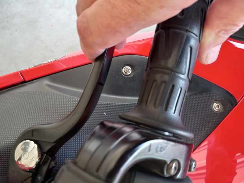

Hubster, I have a bit of a problem with the front brake lever on my ZX-14. I have the lever reach adjustment set to 1 (maximum span) and the lever comes almost back to the grip before I get any brake action, see photo below.
I recently changed the brake pads, brake fluid and bled the brake system. The lever is not spongy like there is air trapped in the system, it just comes way back before it suddenly gets firm, like there is nothing, nothing and then suddenly a firm lever.
What sayest thou, Sir Hubster?

I'm not Hub, obviously. I say bad bleed. Depending on if you let your reservoir empty you may need to bleed your master cylinder, then at your calipers.
If you have ridden the bike, vs say rolling it, how strong is the braking once you've hit the point of resistance? If you have extremely strong braking, like the wheel locks up, it might be the pads needing seated or something else than bad bleed.
If you just installed pads and did all this work, the first thing should be to pump down to seat the pads. If you've done that then it's definitely air in the system.
My suggestion is use a vacuum bleeder, IME they are simpler and result in a more reliable bleed vs pump n purge. And if you used one, it's possible you didn't use it correctly. Sometimes this happens, I have had to re-bleed before especially the first few times .
You probably have a LOT of air, which is why you're not getting the spongy feel which is when you might have a few bubbles in your system.

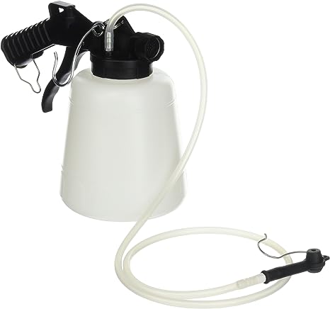

Get a "pneumatic air bleeder" for like $35.00
Uses a air line and no pumping. Completely flush brake fluid every 12-18 months
Only takes a few minutes.
Can't even imagine doing it the old way.
Mityvac is ok if you don't have air. Went through a few of the mityvacs
before switching to the pneumatic air type.
