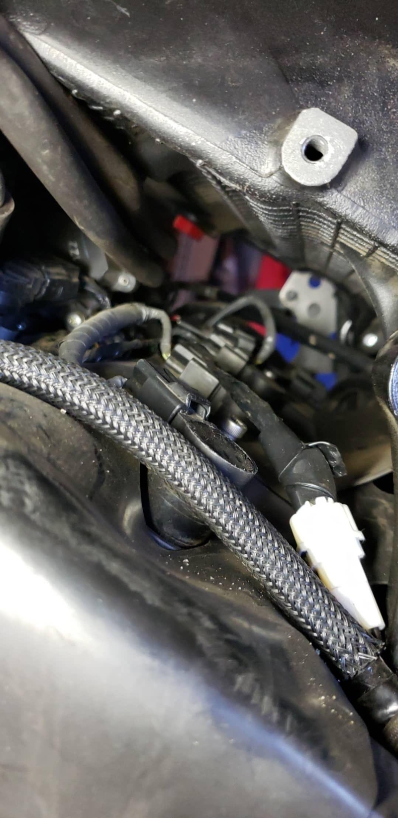

Hey guys, I am very curious has anybody with a ZX-14-R NOT a 14 Experienced trouble mounting the HM Plus *SS Lever. Any help is appreciated!
2012 Custom Matte Black-Silver/Orange Paint Scheme.
Secondary Flies out/ECU Flash & Tune by Nels (2WheelDynoWorks) **Updated to Brocks/GUHL Flash 2 package / PCV Map Switch (Savage Mode) / Upgraded 360° firing Magnum Tuning Spark Plugs/ Antigravity Lithium Battery 480 crank amps/ Custom LED Integrated Smoke Tail Light/ Shogun Frame Sliders /Pair Valve System Removed/ Ek Black & Gold Heavy Duty chain/ Supersprox Gold 43T Rear Sprocket/ Vortex 16T Steel Front Sprocket/CRG Bar End Mirrors/Galfer Wave Rotor on Rear with Rainbow Titanium Grade 5 Bolts/Custom Vinyl Designed Wheels/Pirelli Angel GT 2 tires/ Healtech Quickshifter / Zero Gravity Double Bubble Screen/ Brocks Penta Carbon Full exhaust system/ Custom Raised Rubber Permanent Tire Stickers/ HyperPro RSC Steering Damper / Motocomposite Carbon Fiber Fairing Accents/ Clear- See thru Clutch Cover/
RE: HM QUICKSHIFTER LEVER PLUS SS DOESNT FIT?!
02/18/19 6:46 AM
What? The splines don't match? The lever is too long?
I have the HM+ but it works with a linkage rod and it is on a Gen1.

Like Rook I have an HM Plus but on a 14R.
Fit perfectly (except the need to have the hands the size of a 4 year old to connect the quick shifter leads to the coils).

Thanks for responding guys first and foremost!... Yes Rook, the splines did not match. I guess one of the machines at their factory malfunctioned and made the splines circumference to small. So kind of jumpstarted a small Recall. I'm just waiting to get the damn lever back! I even sent them my OEM lever for reference. They said this is the first time something like this has happened. Apparently Aprillia and our bikes are suppose to fit the same. Somebody slipped the ball. Almost 3 weeks now and counting. Mounting everything else was a piece of cake!
You're a better man than me Charlie Brown because splicing in the connections to the top of the coils in the very tight and restricted space available was a nightmare for me when I installed my HM Plus quick shifter.
And I know because I did it twice.
Once on my Gen1 2007 and once on my Gen2 2012.
Definitely glad it went well for you 14isKing.
But you must have very small hands...

BTW, Looking at your pic you seem to have a shitload more room above the coil tops than I did.
Wish I had that sort of working space/area.
I envy you...
