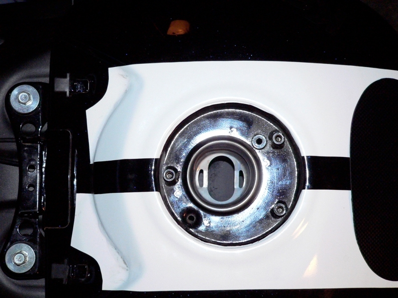

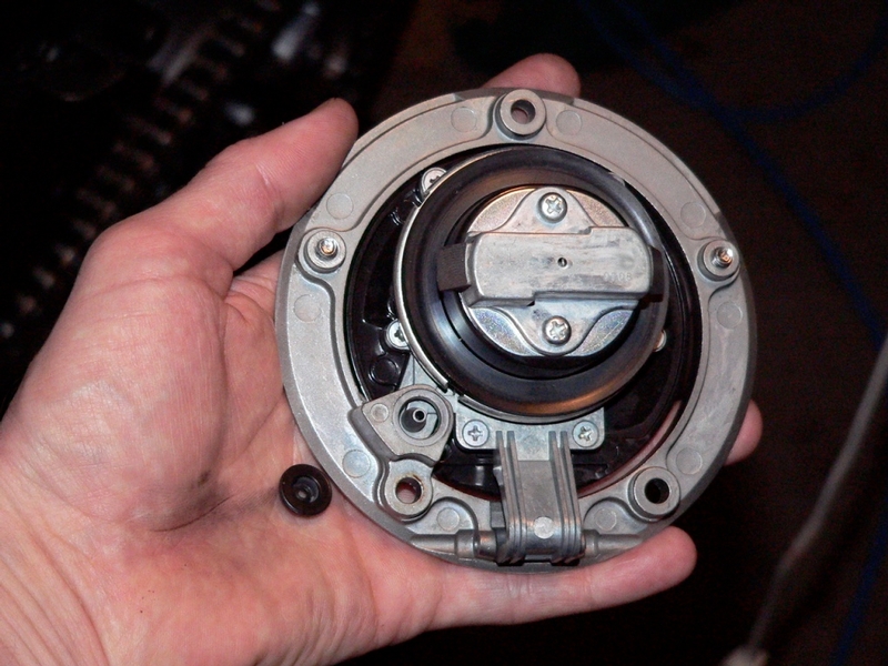

It's supposed to come out of the nipple and go through a steel tube in the gas tank that leads to the nipple at the back of the tank where the rubber hose is connected. Problem is, they seal the steel tube with wax to prevent fuel tank condensation. When you hear it whistle, that's probably the vapors not going through the nipple because it's clogged. The vapors squeeze out of the filler neck gasket instead.

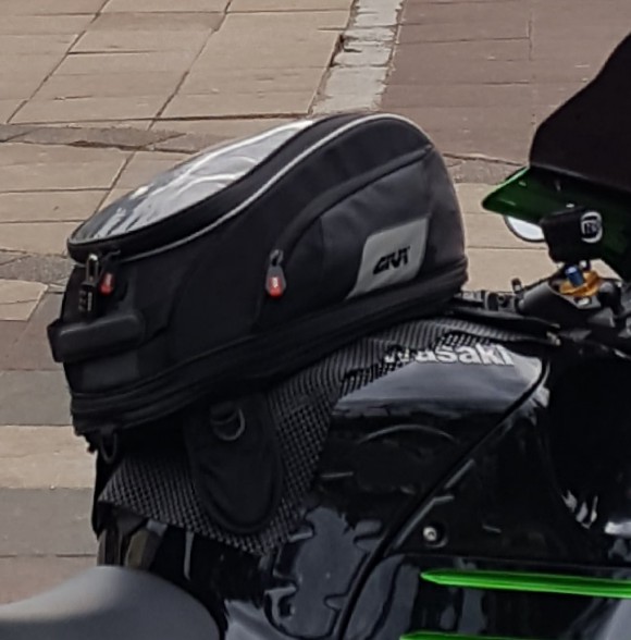

Putting some spacers under the bag won't hurt. I guess i'd put vinyl on the tank like I have so the clearcoat doesn't get marred. If you get any rubbing from the spacers, it should be minor and polish out fine. You might have a little trouble getting your magnetic tank bag to stick though.
If it was liquid,it'd run down into the overflow deal.But since it's vapors it doesn't get forced down.
If it was liquid gasoline, the pressure and solvent action would dissolve the clog. It would work how it's supposed to. If there is enough vapor pressure to squeeze past the filler neck gasket and/or the overflow nipple gasket, that's plenty of pressure to go down the tube if the the tube was unclogged.
Also, I have an aftermarket gas cap and that might be why mine doesn't whistle anymore. There's no nipple with gasket on a LighTech. Just a hole. Not really the best for the paint in the fuel cap ring recess. My EvoTech on the busa has a rubber tube you can shove in the overflow vent.
