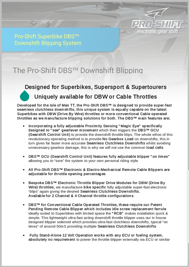

Lol mannnnn Wisconsin... I could only imagine the weather you get. Proshift finally responded to me about their DBS system.. I have no doubt its probably a quality piece but geez at $1320 for ou bikes whoa!! Maybe later lol

RE: Is their a Difference between HM’’s Flagship *GP* Quickshifter vs *Plus SS*Quickshifter model?
03/25/19 6:36 AM
WOW. I wonder what the blipper would cost for the HM GP. I'll bet that is pricey too otherwise HM would make their own.

Yep, I think HM makes a Blipper assist like trans logic but its only for certain bike applications or you have to call for special orders. But yeah maybe down the road.. might try Proshifts DBS system. Quality stuff there as well!! Really wish translogic would have still been making more applications for our bike. I would have went with them and been done with it.lol
