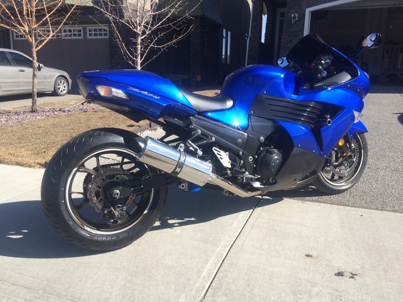

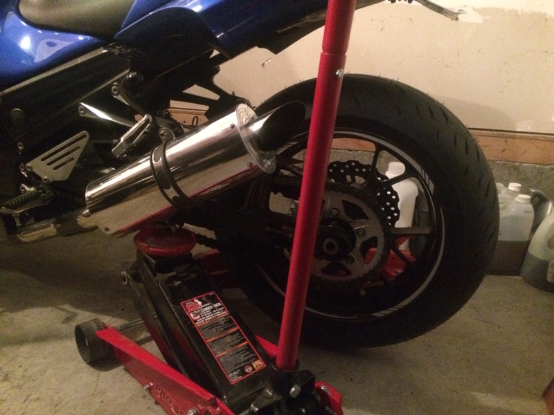

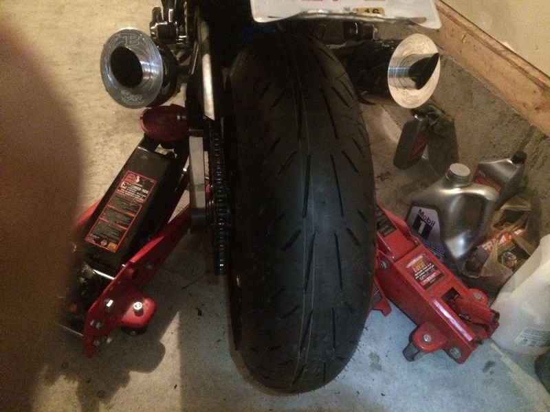

Here are the old vs new pics. Sorry I will get it out of the garage and take a better profile picture of it from a distance but for now this shows the tire. I really do not believe that it is as big a deal as thought for the 200 width. It fit no issues whatsoever on the rim, and there is really no "squeezing" to speak of... as a matter of fact I measured the width on a Metzler spare 190/50 r17 tire vs this one, and the difference in mounting difference is a couple mm's... plus as said the old Exedra tire was a 200/50 anyways, and it was also about 2 mm wider on each side when looking at the chain guard and where it sits compared to the old tire.
fills the back end much nicer... this is a track tire, so the profile is more rounded for quicker drop in during turns. The profile height is nearly 2inches higher than the old 200/50 which was worn down but still noticeable. This raises up the back end almost 1 inch, I could feel it the moment I sat on it.
For me this is a good thing. I was shocked I started scraping a bit of metal on a fast sweeper a few days ago so I am happy to have greater ride height. This has lowering links, and the set up was with lowering links on the longest (lowest) setting. Previous owner obviously did not care to turn so much. I understand for "drag" lower is better, but for using this bike as it was meant to be used, fast everywhere, I want more height... I do have a track-able Street R1, so that is my bias anyways. Plus after I get this tire out for a ride day, my plan this weekend is to raise the rear "up" one hole, so I can actually get my knee down a bit rather than this bike turning like a cruiser...
My best recommendation is go with what a tire that you want, do not worry about reduced patch etc unless you are using that last 2% of the bike performance. For touring, go with a good sport-touring - for fast straight or drag, slam it and go with a stock or even 200/50. For the twisties and track or fast turns there is absolutely no issue whatsoever going with a 200/55, especially one on sale!
as for losing torque, yes you will lose some due to it being a taller tire... however my bike is already -1 and + 3 on the sprockets so it is already significantly geared lower. A bit higher gearing with the taller tire will be hardly noticeable, will pick up an additional 3-4 mph at cruise speeds for the same rpm.

PS per discussions about tire huggers, I do not know but I think it may scrape. Mine does not have one due the 9 inch extension and Big 'ol Nitrous bottle siting there now! Looks much better than a tire hugger..
Anyways, if you put in some spacers or stack washers under the hugger, you may be able to fit the stock hugger over a 200/55. As said it would be almost 1 inch higher radius than my old 200/50, and almost 1.5 inches higher with a 200/55 vs the stock 190/50.

Had it for a little spin, she definitely has far more grip than the harder sport touring Exedra! No issues whatsoever with what may be a "smaller" contact patch, and as said pinching is minimal to non-existent. If there is, a wider tire, even if taller, will still have almost an identical patch-size due to it being a slightly wider tire to begin with. If indeed the contact patch is smaller, it is so small as not to affect performance or grip. I am much more confident in the turn now with this tire, not so much worried it will slide out on cooler temperatures. Lean in is far better, and MUCH better drop in feel on turns. I like that!
I will be eventually replacing the PP4 sport touring tire with another PP Power Sport. Then I will not be afraid to drop my knee down as much (after raising the adjustable links 1 notch for a bit more ride height). Reducing ride height on the back end reduces stability due to increased trail on the front end; the taller tire helps reduce trail which REDUCES stability and increases how quickly it drops into a turn. "tire pinching" (which is barely a factor from a 190 t0 a 200 width, IMHO now that I have had two 200 width tires on my bike) is not a noticeable factor here, it being so small to begin with. At most you are only talking about 10 mm on the widest part of the tire, and you also need to remember that a 200 tire vs a 190 tire, the inside width as per the manufacturers, is meant to fit a majority of rim-widths in the industry. The standard rim width on most litrebikes is 6", so the 200 tire is designed to fit this by the manufacturer.
I get the bike looks cooler with a slammed back end, but your maneuverability is reduced due to increase trail on the front end. (Being a convert from a cruiser into sport bikes, well, I will not go back to the lazy steering feel of a cruiser again). With the ride height being dropped due to lowering links, raising my back with a taller tire, only gets it more back to normal of the geometry of the original set-up.
The trick to grip is not so much the contact patch, but the tire itself. With all the multi-compounds, the tire softness is still the greatest factor in grip. You want to sport-tour then go with a harder tire for longevity. You want to drag, then go with a Shinko super-soft drag tire and replace it every 10 runs! You want to use this as a hyper-bike, then go with a softer track-street tire, plain and simple, and accept it will not last as long - I think sometimes everyone overthinks tires too much...
As for the hugger, I do not think it has to look backyard, you are really only raising it, and the only thing you may notice is that the bottom of the hugger is raised off the swingarm. I did this on my R1 hugger by a couple washer-widths to make sure I fit the 190/55 tire and you do not see the washers - plus after final adjustments where it needs to fit, the clearance was similar to the 190/50.
So in short, do what you want but for me, no issues whatsoever to mounting a 200/55 and only gains to every aspect of handing.

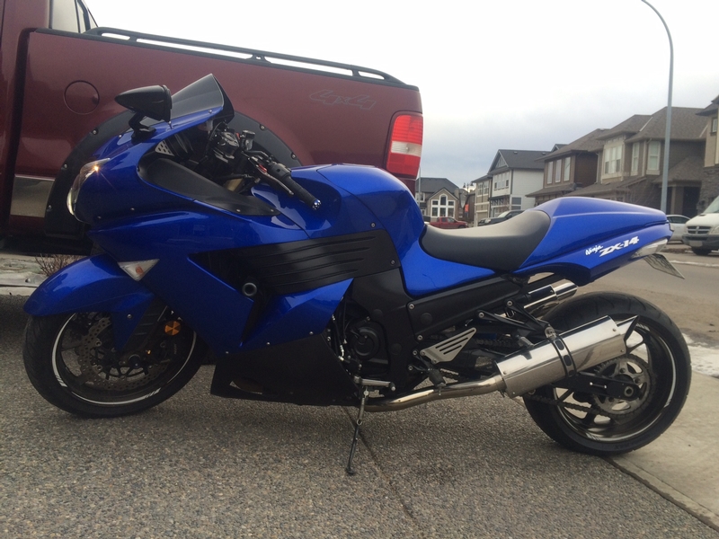

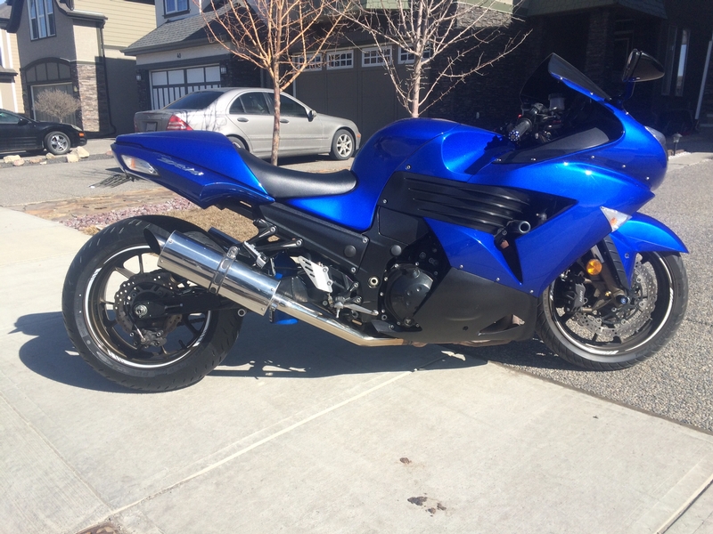

[img]
2 pics from ride, I am liking the size for sure, see last post for the update with the 200/55. Hope it can be of some use for your decision...

Posts: 1828
RE: Putting on a 200/55 r17 Michelin
03/19/16 10:53 PM
That's a big ol' chunky tire! Lookin' good. Thanks for all the info and pics.
