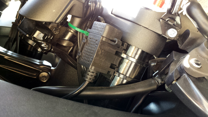

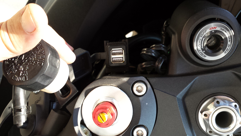

remove right side fairing. Run cable from battery along with factory harness to
the front.
Extra wiring to right of USB plug is for my heated gloves.
