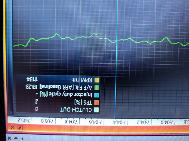

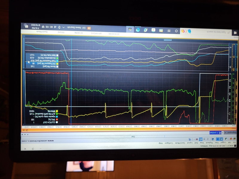

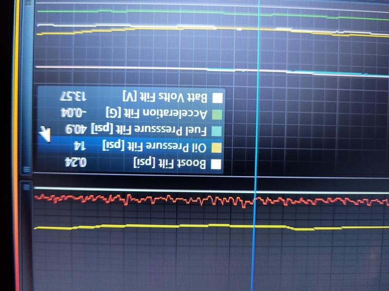

I run a turbo 14 drag bike with a data logger. I'll check a log tonight and let you know. I'm pretty sure it's in the 16-18 psi hot after a pass at idle. I'll try to include a screen shot.

The log is about 8 minutes total. Top of 5th in full screen shot 80 psi. Next 2 partial screen shots are 7 minutes in at idle you'll see about 1100 rpm 13-15 psi consistently. 10w40 Motul Dino oil, factory Kawasaki filter.

Thanks FordTech! thats exactly what I needed to know.
Looks like I need to either find some RPM activated switch for the accusump, or I will have to manually shut it off at idle unless I want to absolutely flood the engine with extra oil.
