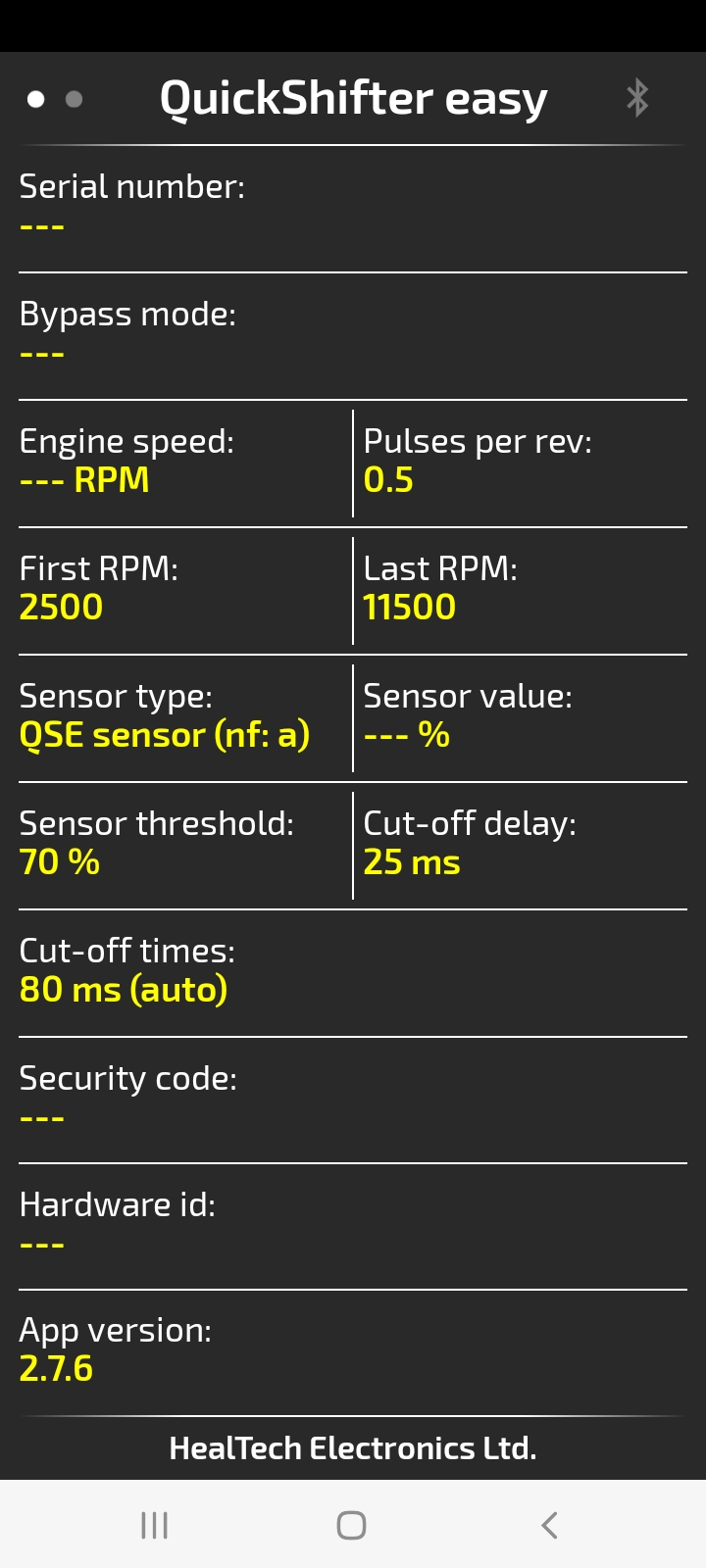

02/13/23 4:17 PM
I know this is an older post but here's where I ended up with my settings. Going to try to take it to the track this week to see if I see an improvement in ET

03/02/23 1:36 PM
Okay I took her back to the track and I had to increase the cut off delay from 25 to 30. I only got one more pass after that but seemed to shift ok. I was shifting at 10800. Good luck!!!
