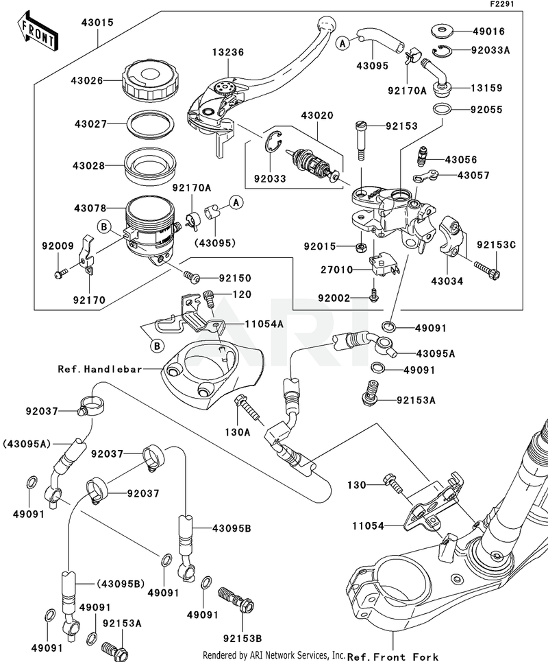

Hubster, my 14s front brakes were feeling pretty weak, lever was firm but coming back to the grip when hot so I decided it was time to change fluid and bleed the brake system.
I used new DOT 4 fluid and bled a lot of air out of the system, now feels like new again and lever is very firm and out where it should be.
My question is on the black rubber diaphragm in the front reservoir. The service manual and owners manual say nothing about the purpose of the diaphragm or whether it should be fully collapsed or fully extended when servicing the reservoir.
I assume it prevents the brake fluid from sloshing around when the level is low and thus prevents unmasking the intake port to the master cylinder.
Also creates less space above the fluid to draw in moisture.
The manual says to service to the top line but when you do this and the rubber diaphragm is fully extended, it pushes fluid out as you screw the reservoir cap down. I ended up filling to the low line on the reservoir and then with the diaphragm fully extended and with the cap screwed on, the level was pushed up to the topline.
This seems like a fairly important detail omission in the service manual. Is the proper method to collapse the diaphragm completely and then service the reservoir up to the top mark?
What sayest thou Sir Hubalot?

No, that is precisely my point, my reservoir diaphragm is fully extended, about 1 1/2 inches in length and it appears to be permanently deformed in to that extended position, as in it is FUBAR! Looks like I need a new one as it doesn't look anything like the one in this parts breakdown ref. item 43028. Remember this is an original '06 and is now almost 17 years old, so kind of getting up there in age now.

His brake fluid dropped quite a bit. The diaphragm extended to displace the reduce amount of fluid. Fold the diaphragm back in, fill the reservoir to just below the UPPER line, put the diaphram on and screw down the cap. Don't over-tighten the cap there are specific instructions. Expect a small amount of fluid to seep from the bleeders and the cap, take measures to prevent droplets of seeped fluid from flying onto the bike. It takes several weeks before the cap and the bleeders form a drip-proof seal. I tried tightening the bleeds a hair more but I don't think that helps much. Obviously, you shouldn't tighten the bleeds more than specced or the threads could be damaged and you have a real leak problem. I believe Grn suggested teflon tape on the threads some time back. I bet that would work but I'd be worried about tiny chunks of teflon in the MC...even though the tape does squash down to about nothing when you tighten.

Diaphragm acts 3 ways. One is to keep the surface airless so no condensation mixes with the Dot. Next is atmosphere so the fluid can move and remains neither locked at a vacuum suck or a push on it as pressure, but remains at a neutral or zero pressure (14.7 psi). Last is fluid loss due to pad wear and the diaphragm can follow down keeping an air bubble from causing it to leave an (air) gap.
Expand the diaphragm. Completely dry it with a paper towel. Collapse the diaphragm to install. Wipe the top ring of the master dry so both contacts acts dry. Fill to said line. Note that you have the pistons set farther out in the caliper, adding more fluid. Once it's time to replace the pads, remember to take a little out of the master before retracting the pistons back to home.
