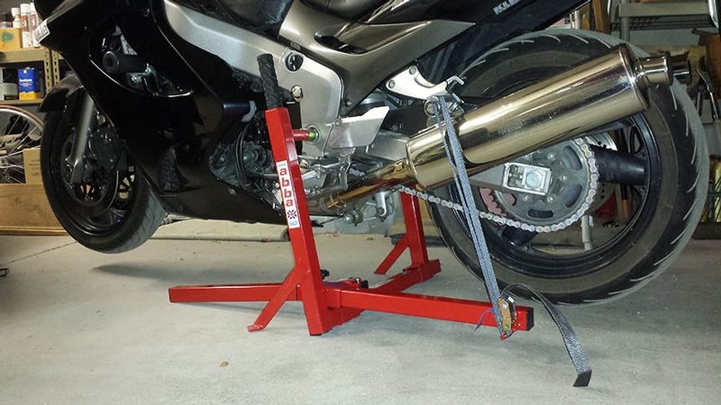

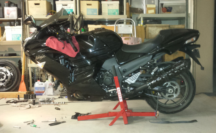

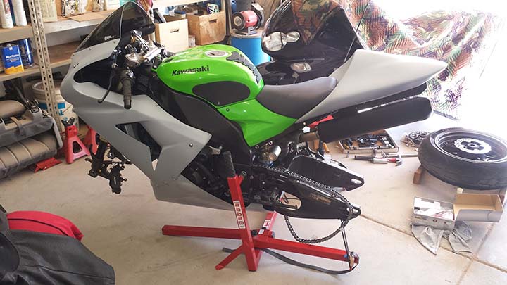

Abba stand. Also will allow to remove forks, steering stem, rear shock, etc. for maintenance.
