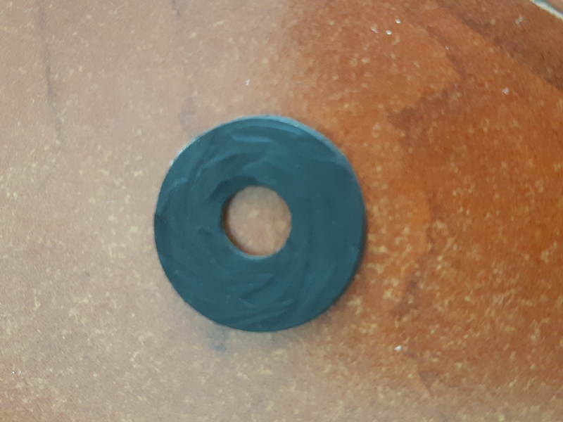

I've just taken the upper fairing of my 2008 ZX14 and whilst cleaning it a black rubber washer fell off.
It appeared to come from the the area where the mirrors fasten on. I most definitely did not encounter any of these washers when I took the mirrors off. I've looked on the parts list but they are not very clear. Can anybody confirm that there is, or is not rubber washers on the mirrors. If so where do they go? Or do I just have a rogue washer hiding out in the front fairing.

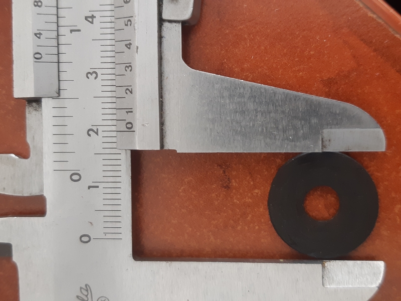

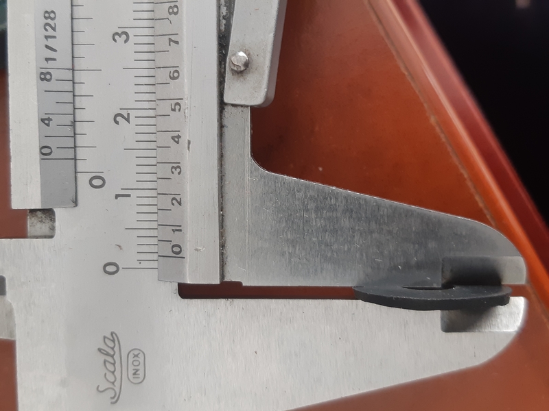

Thanks for your help. The 92200 as you say are the little white nylon washer. I have all of them.
This washer is too large to be a fragment of a well washer.
See pics below. 19mm OD, 6mm ID, and 1.5mm thick.

There's not supposed to be anything like that in the top cowl. If somebody owned the bike before you, perhaps they dropped that in there by accident. From the first pic in your last reply, it looks like a razor knife was used to sliced it off of a larger piece. I wouldn't worry about it. Perhaps someone was trying to put extra cushioning in the meter unit mounting bolts? The meter unit is supposed to have a little slop in it but it has rubber grommets for cushioning.

When I fitted the Laminar Lip I re-drilled two holes and then I put these black rubber washers either side of all 4 holes on the Lip to cushion it. When I removed the Lip one of the washers must have stuck to the outside of the MRA windshield and then fallen inside when I removed it. I did this mod quite a few years back and had totally forgot about the washers that I had used ( I'm practicing for when I retire)
